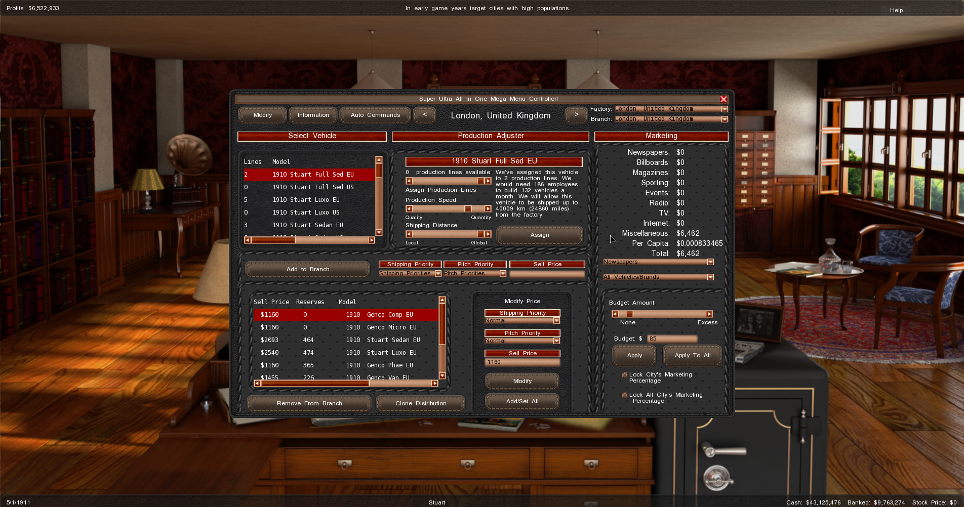

I just had something similar happen to me.
See screen shot, the game just zeroed out all marketing except for misc on all of my cities.
Save file also attached.
