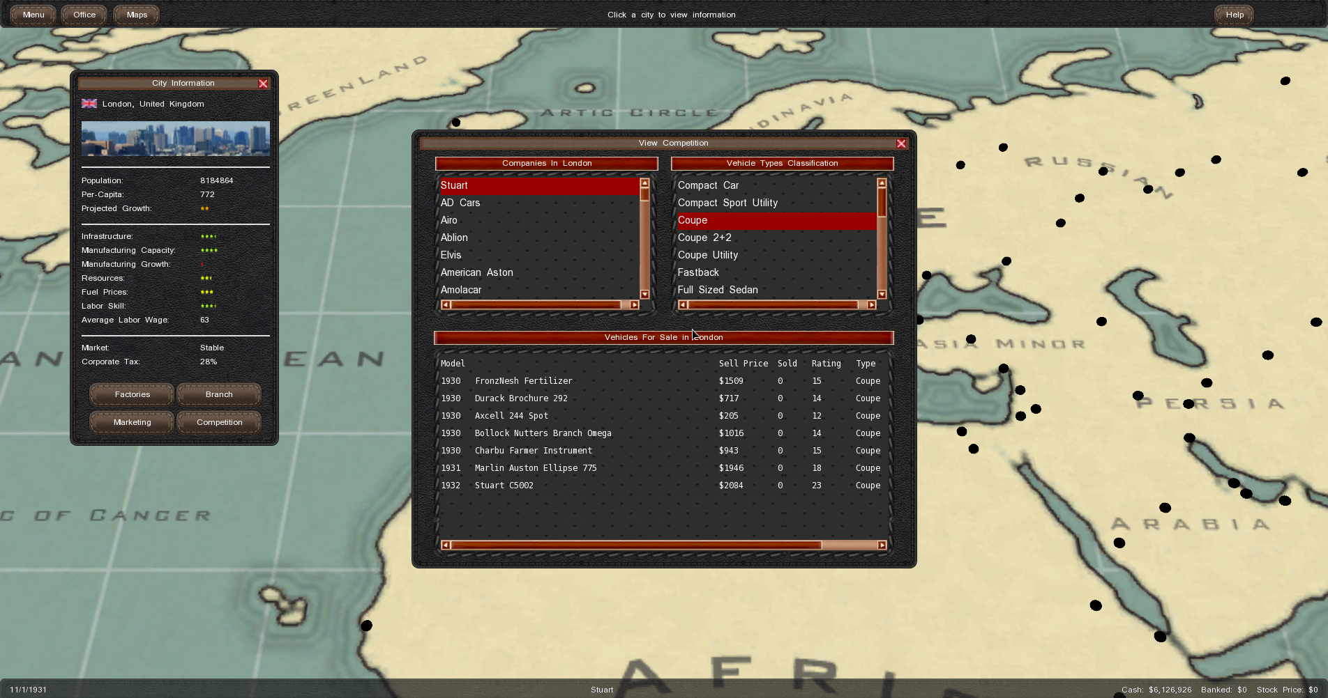

Playing 1.15.4 and as soon as I launched my coupe (so far my first and only car), every city I offered it in stopped buying coupes of anyone. They still sell in other cities, just not where I am.
I tried opening branches in new cities and as I did those new cities stopped selling coupes as well.
Screen and save attached.

Upon extra investigation I found a bug. Making a hot patch for it.
There is an issue with the sales code when the vehicle year is newer than the current year. Temporary solution is to make a new vehicle's model year, the same year that the design is finished on.
