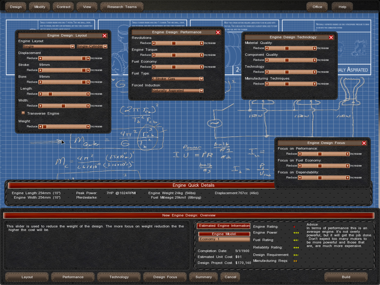

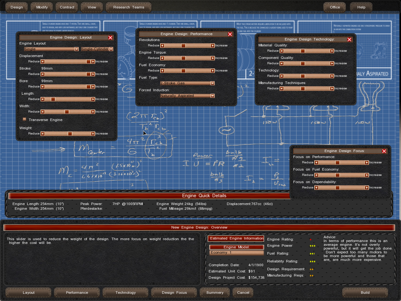

Ive found a bug in the engine designer that is basically allows an exploit of the weight slider.
In R&D Engine Design
Normally when i change the weight slider it works properly, decreasing the weight of the engine but increasing the cost and time of the project to do so.
Ive found that if i set the length width sliders of the engine in a specific spot, the weight slider doesnt make any change to weight when its moved to max or min.
In order to make it happen:
1. Set Displacement to max
2. Leave the Weight and Width sliders in their starting position
3. Move the Length slider down until you notice a large (1/3) drop in engine weight
4. Try moving the weight slider and you will notice it no longer does anything.
Here is two screenshots to demonstrate
http://www.ventdev.com/forums/attachment.php?aid=825
Ive noticed that it can happen at other slider positions, but this is the most visible way of doing it.
