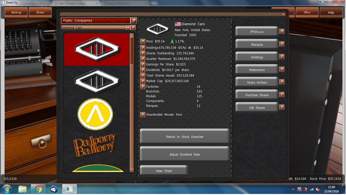

The second, and more annoying bug I found was related to own shares. I probably broke the code while buying another company that probably owned some shares of my stock, but this I am not sure. As a result of it, when I go to the holdings buttons, it shows me Diamond Cars (my comp) twice. It indicates twice the same informations, and when I sell shares from one, it also has effect on the other! I tried to go through the problem by using merger, but it gave the same result. I was not able to restructure as the button seems to have no effect also... So I now own 80% of my shares, and when I click the shareholders buttons, it shows me: "Diamond Cars: 18,7%". Meaning the only shareholder of my company except me is me... Impossible to cancel this, I'm stuck in stock ;-)
And last but not least, once this happened, now I sometimes have twice the same logo in the holdings. Mine is ALWAYS there twice, but I mean other companies too. This happens sometimes but not always. That being said, it happens only when I become the "Owner" of the most shares (51%+).
