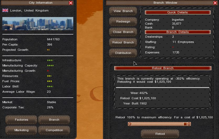

Some of the Branch retooling costs are getting really excessive.
Edit: This may be a bug with redesign and wear, see my other post in this thread.
I had a branch from game start until about 1902.
I decided i probably needed to expand it, so i redesigned the branch.
Then i checked to see if it needed retooling as well (as redesign doesnt retool atm), and the cost is listed as 1mil, which is totally over the top imo, its not even a big branch, probably cost 10-20k per month.
I demolished the Branch, and built a new one instead, which was 900k cheaper, but forced me to remanage all the sales/marketing.
Might have something to do with the -302% efficiency. I reckon that's a bug!

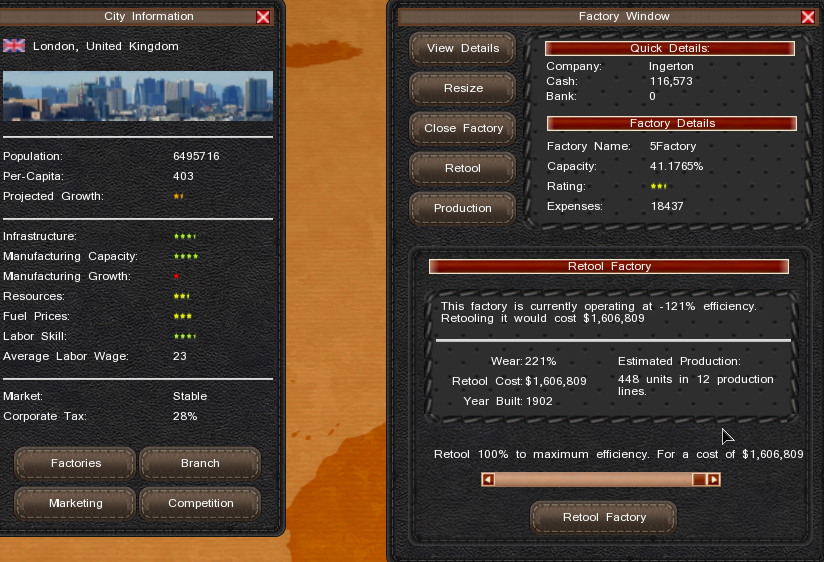

There may be a bug with the general retooling calculation, rather than just branches, look at this.
Again i was forced to demolish in this case the factory and rebuild it, as the retooling cost was out of control.
I suspect it has something to do with resizing/redesiging screwing up the amount of wear on the factory/branch.
-121% efficiency!! Built in 1902 what year was this pic taken?
I've never seen a factory or branch go into negative efficiency but then I generally retool both every couple of years at worst.
(02-04-2014, 12:02 AM)Frankschtaldt Wrote: -121% efficiency!! Built in 1902 what year was this pic taken?
That was a Factory from game start, which i resized, i think the screenshot was from 1903/1904.

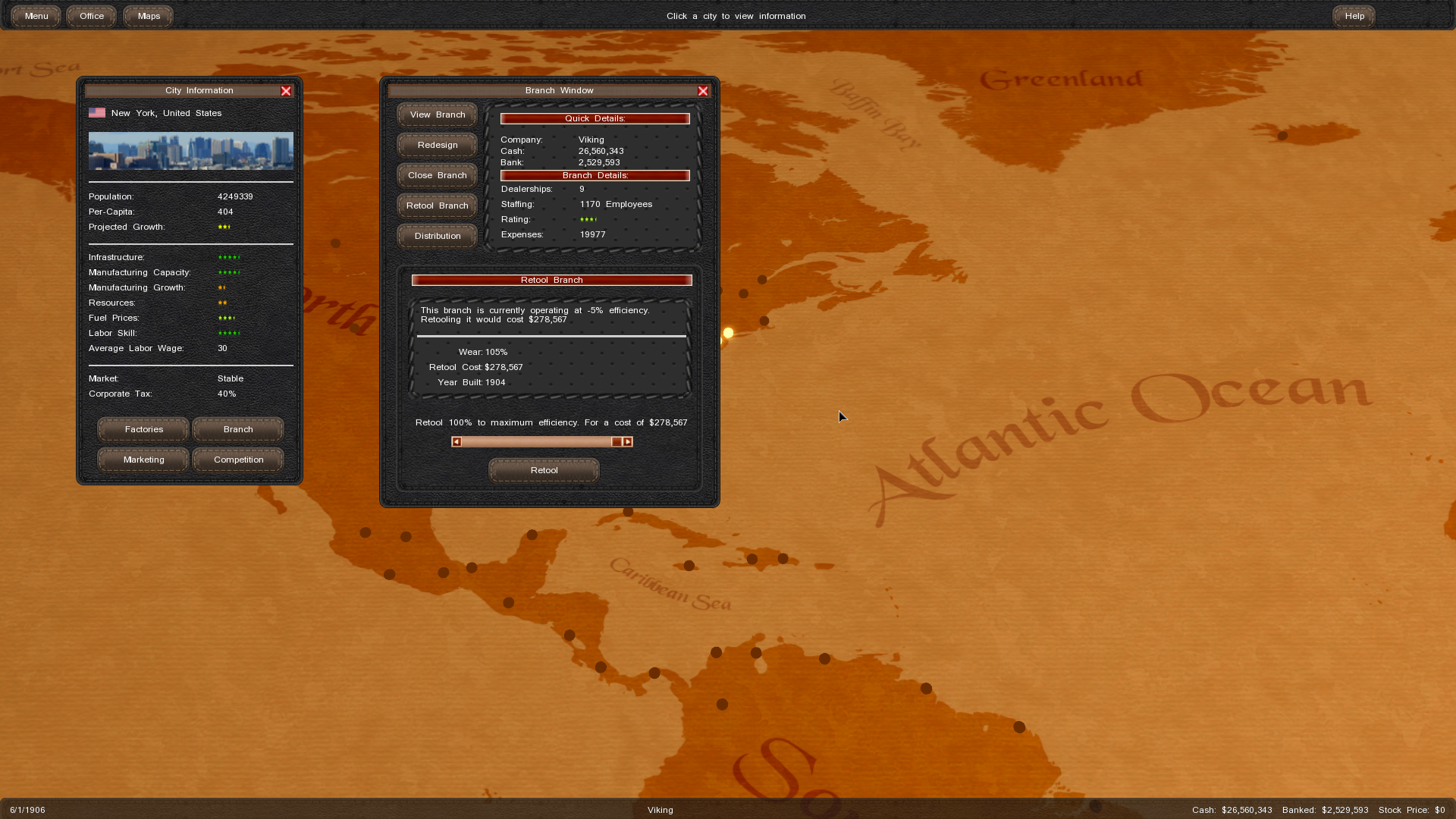

I took a SC of one of my factories in the retool screen
Then i resized the factory
Then i took another SC of the factory retool screen.
The wear hasnt changed.
I also did the same for Branches.
No wear change
Previously, resizing would mess up the wear causing excessive retooling costs.
Perhaps its a new/different bug?
Screenshot added Smile
