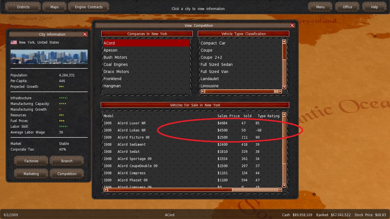

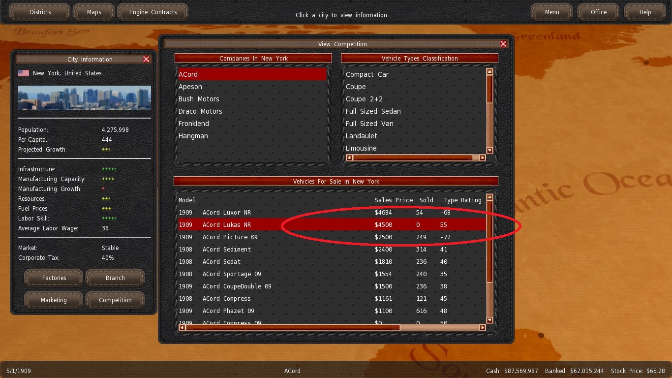

In this picture the model Lukas, has just been researched, rating: 55. Two other models which have shown the same bug Luxor and Picture have big negative type ratings -68 and -72.
One turn later and the only thing I did was start selling Lukas. Lukas is now -68 and Luxor and Picture are now back to normal.

Cartype ratings degrade around 3% a quarter. This of course effects higher rated cars faster than lower rated cars. (100*0.03 = 3, 10 * 0.03 = 0.3)
To fix this in 1.18.2, I made it where any car over a 42 rating only declines by 1.25 points a quarter (Rating - 1.25)
Except I forgot to remove the * sign out of the CarTypeRating, (CarTypeRating * - 1.25) Thus the negative values.
Anyhoo, it's been fixed. It'll be in the 1.18.3 patch. Since this rating isn't used in the buyers ratings (It just shows you roughly what the buyers are thinking), I won't be hot patching it.
