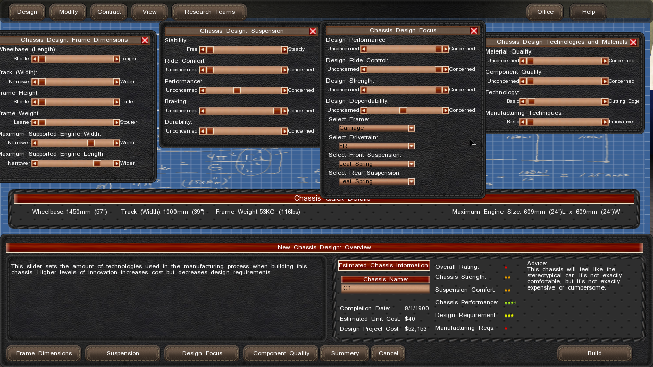

Compare these two screenshots from a 1900 game.
Notice that all ive done is move the displacement slider from the right to the left.
With the current settings(low tech sliders), i can get the same amount of HP (5HP) from 730cc as i can from 2146cc.
I understand that single cylinders weren't efficient in larger sizes for a number of reasons, but that's a 2x increase in volume. I would expect it to have some effect.
Weirdly, the displacement goes up to 6HP at 1.6L then down to 5HP again when it gets smaller.
Edit: 2 Ive managed to narrow the part of this bug where HP goes up with less displacement then down again.
It only occurs when you move all the tech sliders to the left.
With them centered, it doesnt seem to happen.
