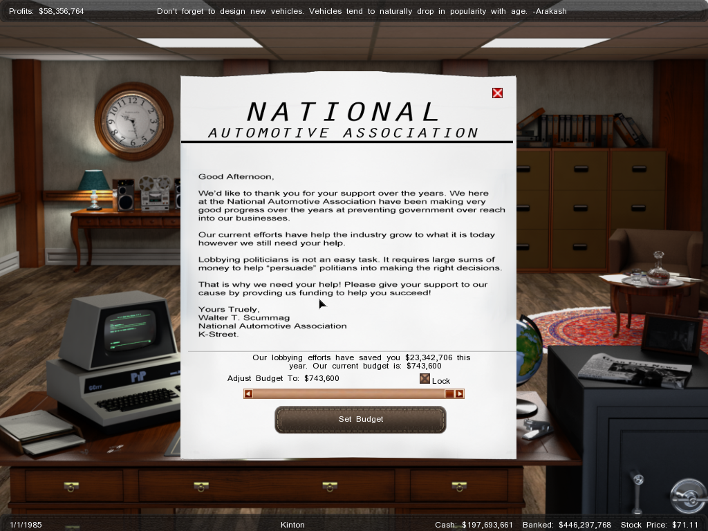

I just noticed that the lock lobbying percentage doesn't seem to be working at the moment.
Ive explained the problem using screenshots and also a standardized example
Using my Screenshots:
The initial values and slider setting isdemonstrated in this screenshot
In the case of my game, the maximum(100%) value is 706,884. I set it to that, turned the lock on and pressed apply.
So in my screenshots, this is what my screen looks like a year later.
The maximum has gone up, as normal, but the lobbying value did not stay at maximum(100%) where i set it.
As you can see clearly its still at 706,884 which in this new year is now probably 80-90%.
I moved the slider up to maximum manually then took another screenshot.
Now the slider is at maximum(100%) where it should have been which in this case is $743,600

OK ive updated the first post with screenshots from a game i just did where i replicated the lobbying bug exactly as i had described it.
I have yet to witness the marketing lock bug since i did originally, my guess would be the first time i saw it i accidentally had the lock button off or i made some other obvious and foolish mistake. Regardless of the reason, i haven't seen it since.
Fixed two bugs in the lobby locking system.
First one Frankschtaldt was correct on.
Second one was the lock percentage did not change if you adjusted the funding amount.
