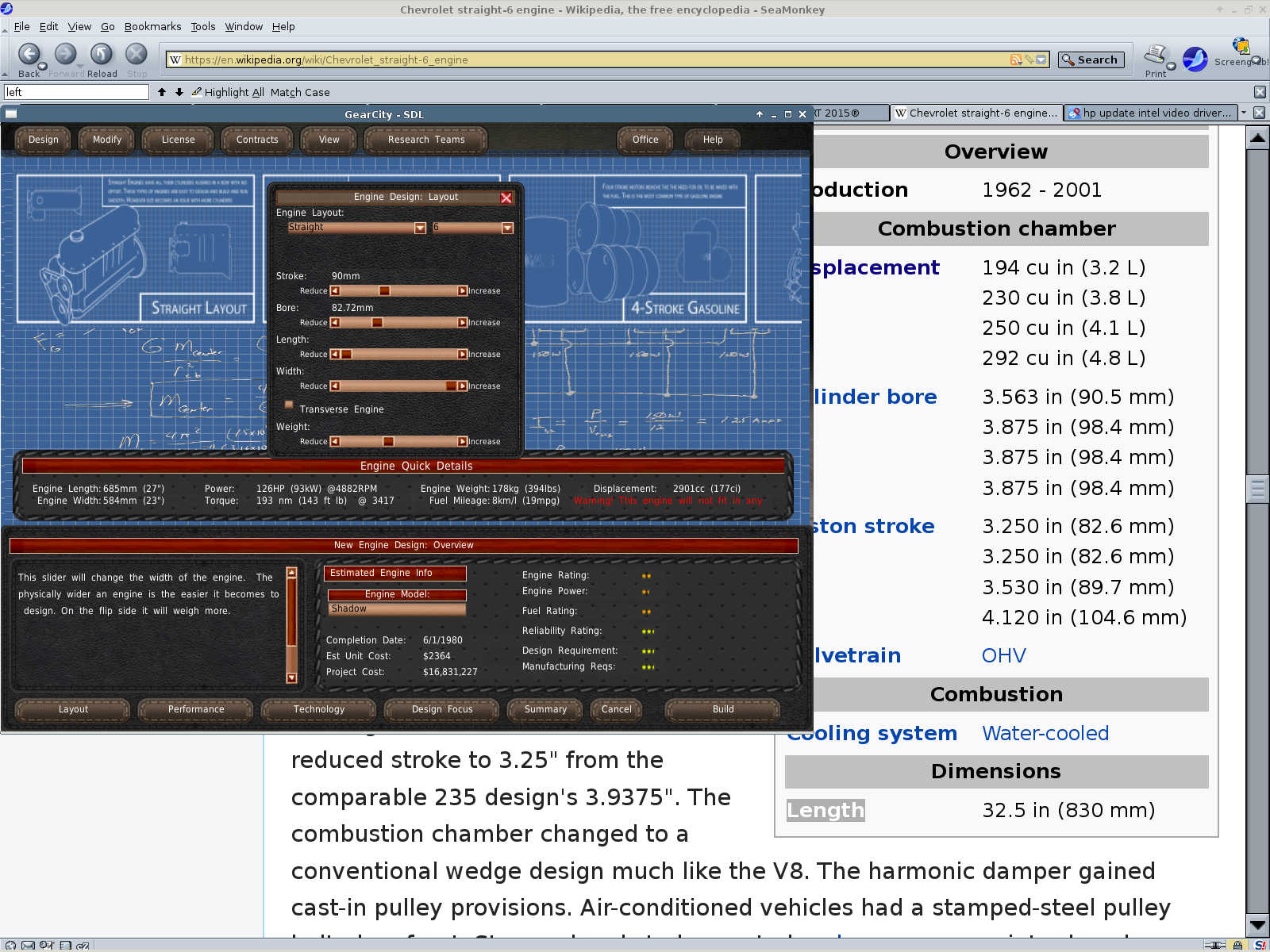

The current system for bore and stroke and calculating engine sizes is weird and produces a number of odd results. Like V12's being wider than they are long or a 3L I8 being the same length and width as a 3L I3 (or very close too it).
Add to this, bore, stroke, length and width all being effected by three sliders each (directly or indirectly) makes for an unintuitive interface that can be hard to grasp.
I believe the following system will fix this without making any of the sliders currently in use irrelevant.
Bore and Stroke:
Remove the effect length and width have on these values. The bore slider has access to the full bore range and the stroke slider has access to the full stroke range (from 40mm all the way up to 260mm or whatever it happens to be that year). No, this wont make length and width sliders irrelevant, keep reading.
Engine dimension:
The bore and stoke are now used to calculate the minimum engine size, along with a few other factors. Now, the lengths and width sliders determine how much effort you've put into making the engine as small as you can for the displacement you've chosen.
These equations will also eliminate the previously mentioned anomalies as well.

So, with the above examples, we design a I6, a V6 a flat 6 and a V12, all with DOHC, Natmo and 86mm bore and stroke with lengths and width sliders far left (x1)
We would end up with the following dimensions:
I6: L 769.2mm (30in) W 279mm (11in)
V6: L 459.6mm (18in) W 365mm (14in)
Flat 6: L 459.6mm (18in) W 451mm (18in)
V12: L 769.2mm (30in) W 365mm (14in)
And a couple of other layouts with the same volume (and valve train and induction) as the 6's above:
A 3L I3 with sq B&S (108mm): L 538.8mm (21in) W 312mm (12in)
A 3L I8 with sq B&S (78mm): L 898.8mm (35in) W 267mm (11in)
A 3L V12 with sq B&S (68mm): L 639.6mm (25in) W 320mm (13in)
Again, these numbers need tweeking but it looks sensible (to me) and it means bore and stroke are only effected by the bore and stroke sliders and the lengths and width sliders stay relevant because they determine how much effort you've put into keeping your engine compact.
