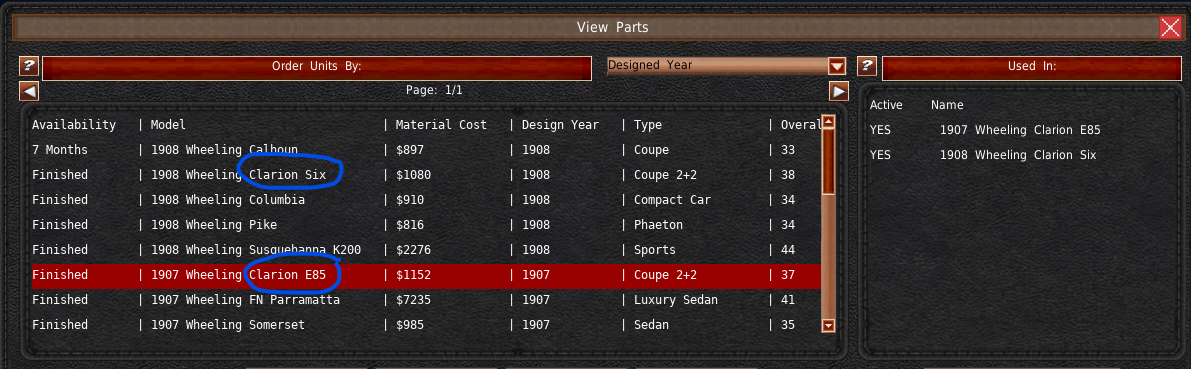

TLDR: I named a trim wrong, renamed it after sales already started, made a new trim with the original name, and now the old name shows up twice in the competition view and single branch view.
I was moving too fast when I built a trim, and put the wrong engine in it. I named it "Clarion Six" (which should have been the name of the gasoline engine trim), when it should have been named "Clarion E85". When I realized this mistake, after I'd already started sales of that trim, I renamed it to "Clarion E85", and made a new "Clarion Six" trim, so I have these listed in my parts list:
[attachment=1528]

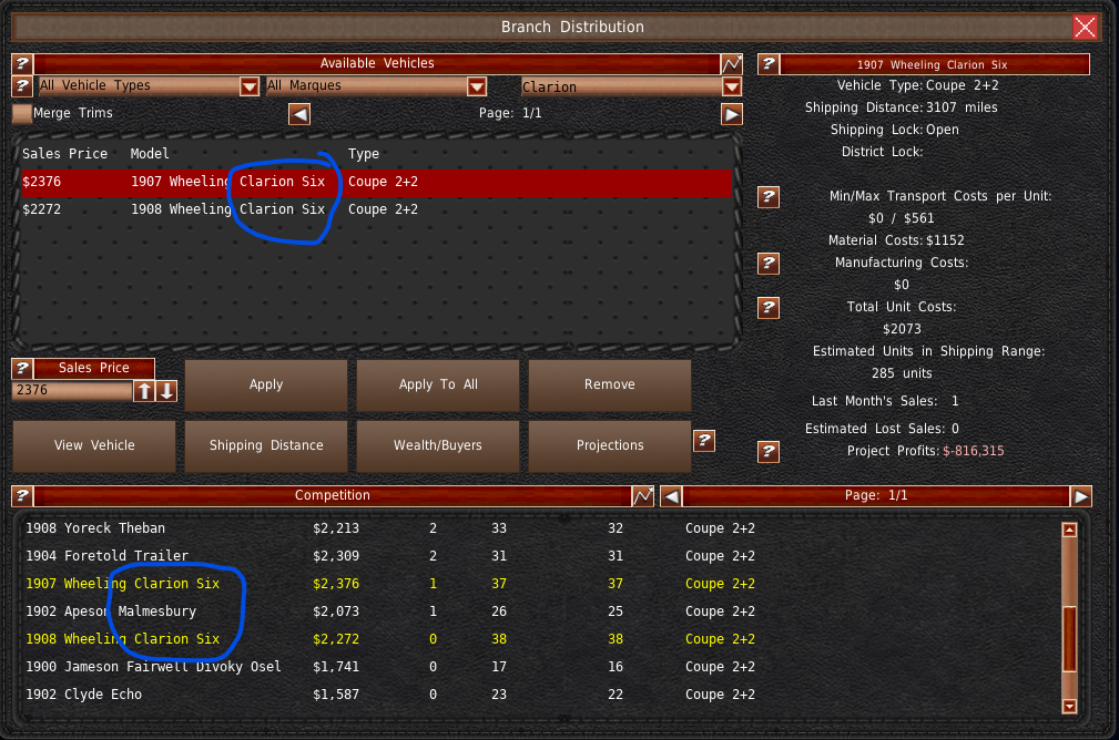

This works fine in the factories view, and most other places, including the TOP of the district branch view (but note that it DOESN'T work in the competition part at the bottom):
[attachment=1530]
[attachment=1532]
(While you're looking at the district branch view, note that the "Average Price" column in the top section always displays $0 as far as I can tell, even though the correct prices are listed in the bottom section).
But I still see the original name in single branch view and the competition list:
[attachment=1531]
[attachment=1529]
If I'd managed to finish the trim in 1907, this would be super confusing (fortunately the new trim finished in January 1908, so I can at least tell the difference between them by the year).
[attachment=1528]
[attachment=1530]
[attachment=1532]
[attachment=1531]
[attachment=1529]
