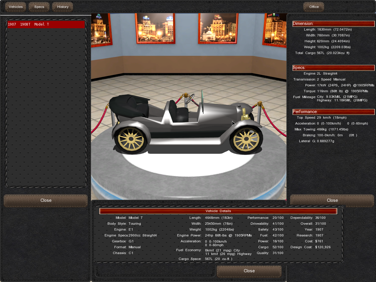

Here is my First attempt.
(youll notice i edited together the R&D screen and Showroom screen to give the most information with one screenshot)
The vehicle size looks a bit bugged, as the two areas dont agree(ill write a new bug report on that). Its either too long or too short, either way, it is not the same size as the Model T.
Its also too heavy, but i think i can slash down on the weight a bit more.
Its price is decent at least. A fair first attempt i hope Smile
I would love to make its dependability higher, but the material/component/paint sliders in vehicle design are very expensive. It wouldve cost me another $200-300 to take it from 2-4 stars)
One of the biggest challenges was actually making a 20HP 4C 2.9L engine with that stroke and bore.
In Gearcity, it has to be a really terrible engine to have that low HP in 1908 with that much capacity. Almost all of the sliders effecting performance had to be on their lowest to reach that.
Its interesting though even with such terrible sliders, it produces more torque than my 1.7L single cylinder design i usually use.
