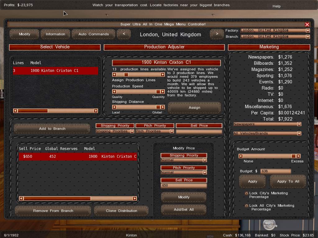

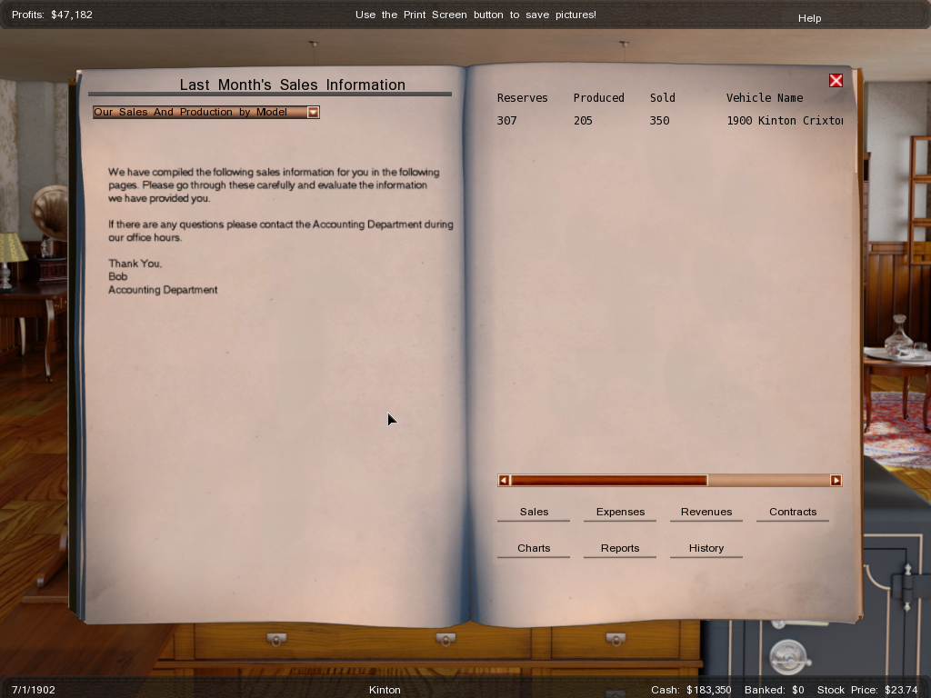

I believe ive noticed this bug myself.
Ive started to notice a large number of odd discrepancies between:
  • the production level i set at my factory (number of cars it says it will produce)
  • the number of cars in reserve and sold during the month
Ive attached an example, with only one factory running.
Edit: Sorry uploaded wrong SC. Fixed now
Edit: It was pretty consistent through my last game.
If you could include the save game, the production code has a lot of other factors that could reduce production numbers.

(05-28-2014, 10:39 AM)Eric.B Wrote: If you could include the save game, the production code has a lot of other factors that could reduce production numbers.
Factory wear is one of those.
I had to go and create another test save to observe this because i didn't think i would need the save to demonstrate it (it was happening every turn).
Ive massively overproduced, to better demonstrate the effect. Its pretty clear here, the number actually produced is 500-700 less than what i set it to.
Attached is a Zip with two folders T1 and T2.
Each has screenshots and saves from two specific turns, T2 after T1.
Included in T2 also is a SC of the Message Box, showing no issues on parts supply.
You can see the bug visible in both the screenshots and the saves.
.zip   FactoryProdDiscrepancy.zip (Size: 4.59 MB / Downloads: 1,058)
