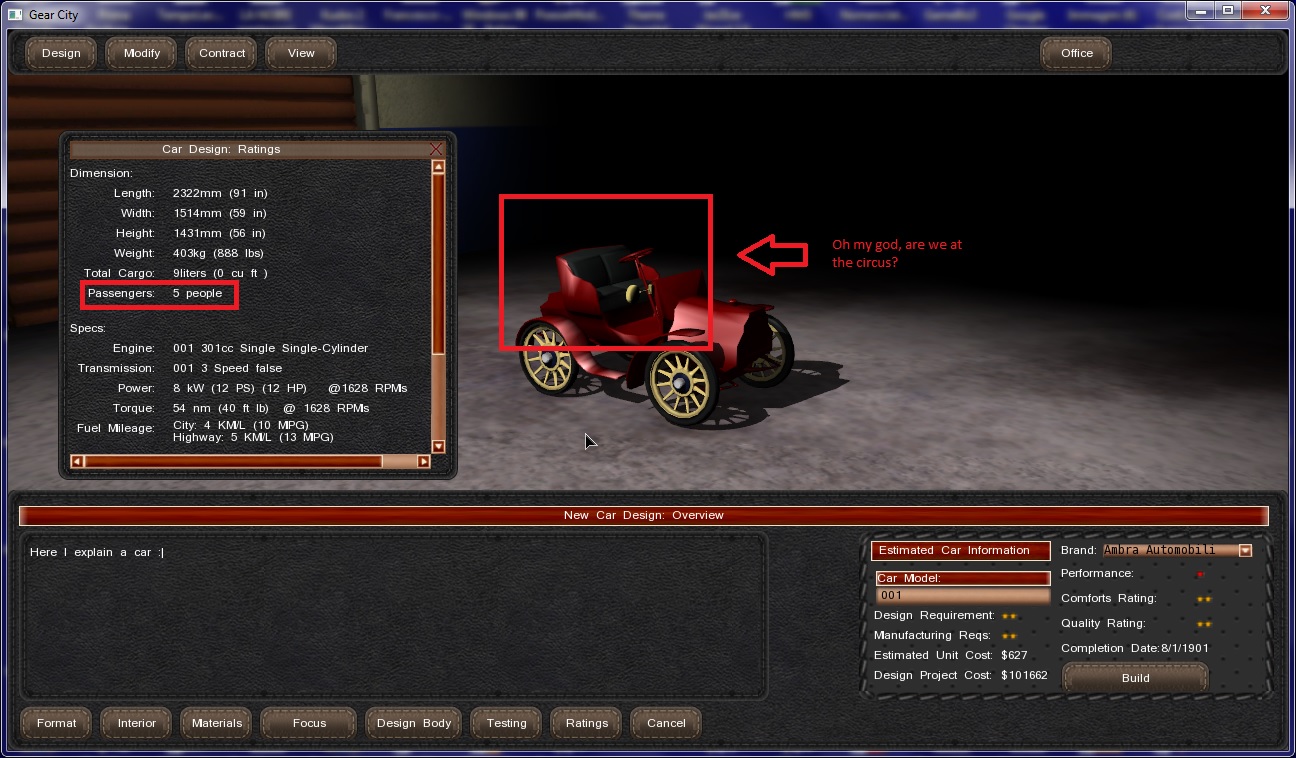

[FIXED]Too many passengers (create car)
My first creation was a commercial failure (no selling, also setting it to 10$ Tongue ), but a marvel of transport...
5 passengers for two seats? (see the image)... Wink
Besides the passengers (that's Eric's deal) ... why a commercial fail? What were you selling it at and how many cities?
Oh... and I love the effort that went into the screen, including the car itself and the captions Tongue

The passengers is a known issue. I have it set per vehicle type and not per base mesh. That being said I think we could fit 5 people in there! biggrin
