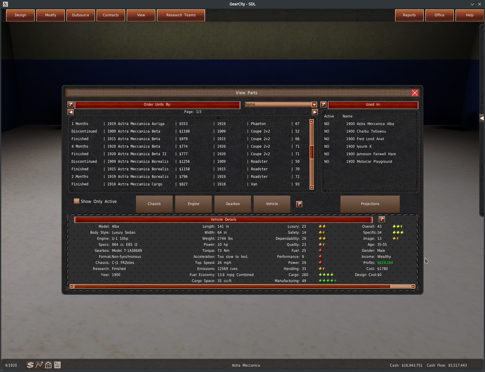

By the way. As you can see from the pictures in link, I have a car model called "Beta". If I want to update the model, I'm forced to change its name because the game says "there is already a vehicle with this name". And of course there is, it's mine! I had very bug (?) on classic Gearcity too, from time to time

Quote:As for the car naming. yes, I always use new generation (almost never trim but I guess I should start doing it for cheaper version devoted to other marques). As you can see from the save I eventually gave up and around 1919 I created a model named Beta II but I am still curious about this issue.
According to the save file, you made 2 Beta models.
There is the 1909 Beta and the 1915 Beta.
You already created a new generation of the 1909 Beta. You can not use this one to make a new generation anymore. You can select the 1915 Beta from the list and make a new generation. I just did that in the save game you sent.
As I said before, I could make a new generation of 1915 beta, but I couldn't name is as Beta. So, making a new generation of 1915 beta is what I just did. But, as I said before, I was forced to name it Beta II. This really sounds like a bug to me.

(06-04-2024, 06:47 AM)AstraMeccanica Wrote: Quote: According to the save file, you made 2 Beta models.
Well the picture I uploaded clearly shows that I was able to make a new generation of 1915 Beta. So, you'll need to figure out what you did in order to duplicate the issue you ran into. IE. When it happens again, try to remember what you did that session. Because I was unable to duplicate the issue.
