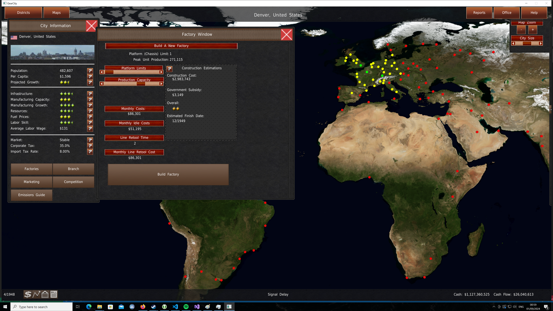

When making a new factory with a high enough Production Capacity the Peak Unit Production seems to wrap to a lower number.
The factory in Denver in this save goes from roughly 271115 to 2900. I wasn't able to create a screenshot of the wrapped around value because of a crash
