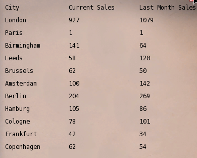

Onother issue: i messed up setting manual wages, so one of my branches went on strike (Paris, see screenshot). I rised their salaries. 3 turns later, strike is over. However, my branch is still not selling any cars (only 1). I have uploaded a screenshot and my save game. My solution is to close my branch, and rebuild it.

It's supposed to reduce efficiency, and at one point it did. I think I commented out branch efficiency to fiddle around with turn speeds. It should be a quick fix, thanks for pointing it out I would of never caught it with the auto hiring/wage system.
When I get to working tonight I'll check the both these issues and let you know when I fix them.

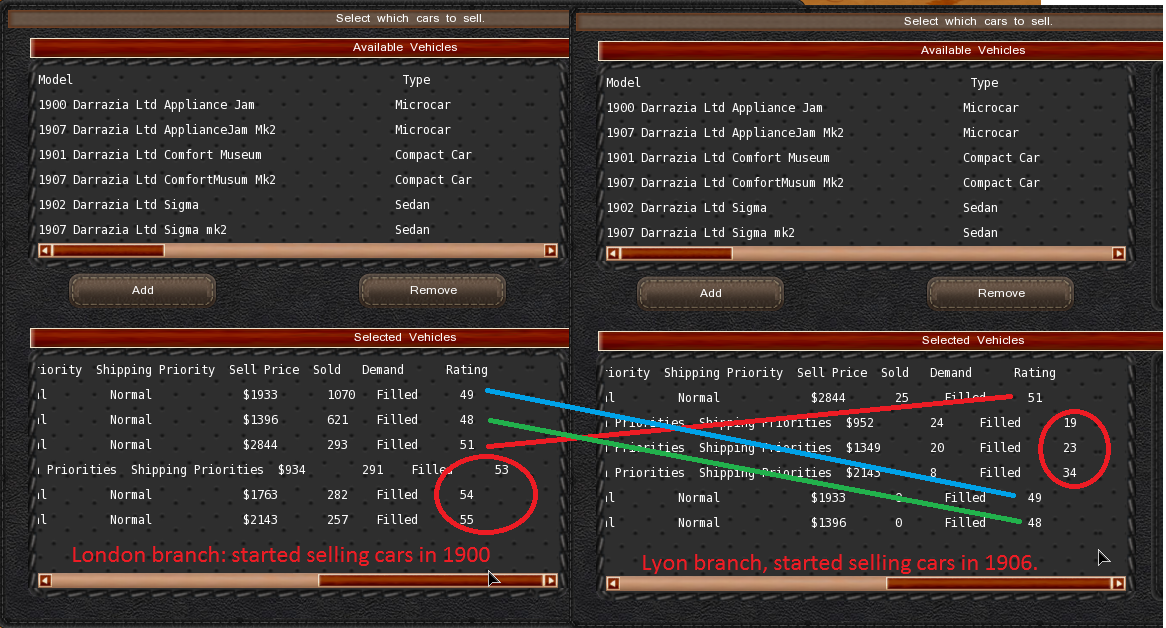

- I start selling a car in 1901. It's percieved value is something like 51. After time passes: the value decreases in my R&D department. However my branch which started selling the car is still being rated 51. Branches which started selling the car in 1906 for example, are having significant lower ratings. I have made a screenshot, and uploaded my recent savegame. If you need more information i would be happy to help!

I've finished everything in the orginal post and it'll be included in 1.09. However the post above this one i'm having a little issues with.
Did you add the cars with the bad ratings via the quick calculator menu? I Think the duplication of names has messed it up somehow.
I will try and explain it better.
1. I Started selling 3 models in 1900 - 1902 in my first branche London. It is now 1907, the stats of the cars have decreased over time in my R&D department.
2. I recently started (1906) selling my cars in a newer branch (Lyon). After 1906 i researched 3 new cars.
3. My ratings for new models in London en Lyon are exactly the same. However my cars i started selling in London in 1900-1902 are still being rated the same as they were in 1900. So my ratings haven't decreased in branches.
Yea I found the bug, but I also noticed other bugs with using the Quick Calc tool. So both issues have been resolved and will be included in 1.09
