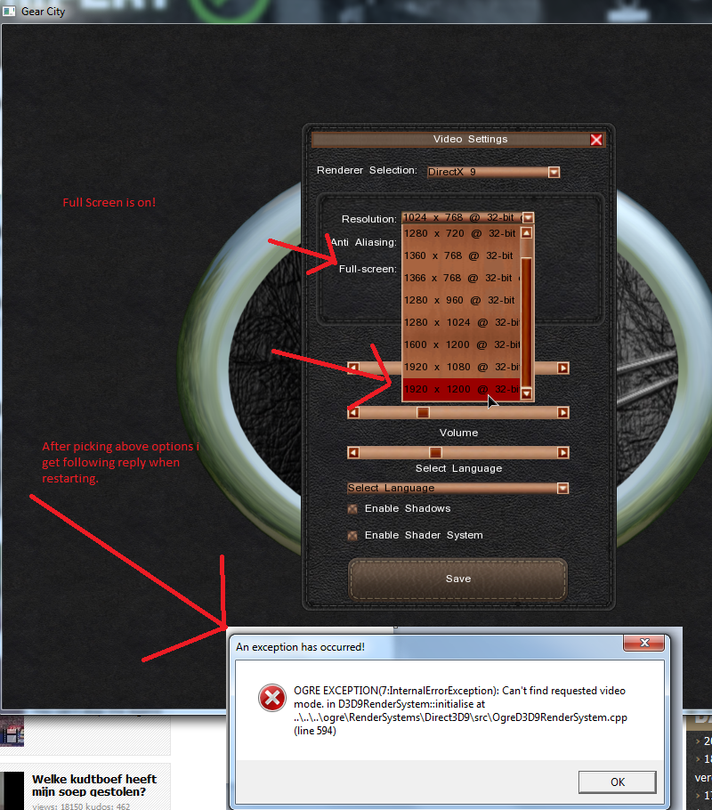

Ok, i got 2 problems to report.
Problem 1:
When choosing settings i show in printscreen my game crashes on start up.
Only when i use these specific options.
I have a NVidea GeForce GTX 560 Ti
